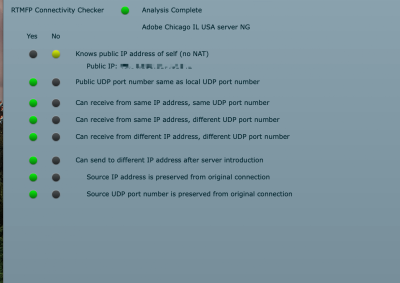

NAT检查工具:http://cc.rtmfp.net/
第一行:是获取 IP 地址 光猫直接拨号连接是 YES 接路由都是 NO
第二行:.Public UDP port number same as local UDP port number
          →这个是指NAT是否将src port做了转换。
第三行:Can receive from same IP address, same UDP port number
          →这个值应当永远是Yes。因为如果连这个检查都通不过,连接根本就建立不起来。
第四行:Can receive from same IP address, different UDP port number
          →如果这个值是true,说明是Port Restricted Cone,它会把出去的包的dst port记录下来,然后收到包时检查port number。
第五行:Can receive from different IP address, different UDP port number
          →如果这个值是true,说明是Restricted Cone,即它不对端口号做检查。
第六行:Can send to different IP address after server introduction
          →这个值应当永远是Yes。
第七行:Source IP address is preserved from original connection
          →这个是看server收到的包是否都来自于同一个IP。这个有一定的假阳性在里面,只要有一次为false,就说明用的是Multiple IP address symmetric NAT。
第八行:Source UDP port number is preserved from original connection
          →true说明是cone NAT,false说明是symmetric NAT。
对照表
Restricted Cone Port Restricted Cone symmetric single IP symmetric multiple IP
Restricted Cone Yes Yes Yes No
Port Restricted Cone Yes Yes No No
symmetric single IP Yes No No No
symmetric multiple IP No No No No
